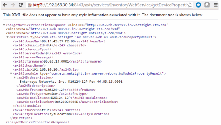

Example
Execute the following web service with a browser:
https://192.168.30.34:8443/axis/services/InventoryWebService/getDeviceProperties?ipAddress=192.168.10.10
