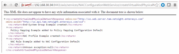

Example
Execute the following web service with a browser:
https://192.168.30.34:8443/axis/services/NACConfigurationWebService/createVirtualAndPhysicalNetwork?name=Example&nacConfig=Default&domain=Default&isPrivateVlan=true&primaryVlanId=100&secondaryVlanId=200&mode=promiscuous&forwardAsTagged=true
