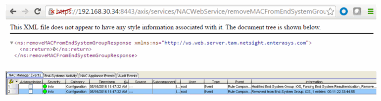

Example
Execute the following web service with a browser:
https://192.168.30.34:8443/axis/services/NACWebService/removeMACFromEndSystemGroup?endSystemGroup=iOS&macAddress=00:11:22:33:44:55&reauthenticate=true
