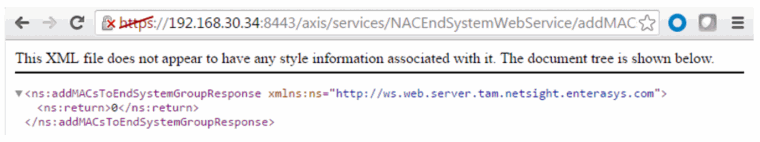

Returns
The operation returns an integer error code.

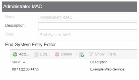

Example
Execute the following web service with a browser:
https://192.168.30.34:8443/axis/services/NACEndSystemWebService/addMACsToEndSystemGroup?endSystemGroup=Administrator-MAC&macs=00:11:22:33:44:55&descriptions=Example-Web-Service&reauthorize=true&removeFromOtherGroups=true
