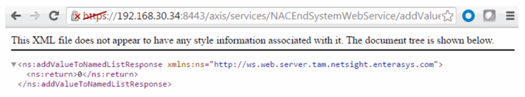

Execute the following web service with a browser:
https://192.168.30.34:8443/axis/services/NACEndSystemWebService/addValueToNamedList?list=Administrator-User&value=jdoe&description=Example-Web-Service-ListName&reauthenticate=true&removeFromOtherGroups=true
