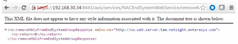

Example
Execute the following web service with a browser:
https://192.168.30.34:8443/axis/services/NACEndSystemWebService/removeMACsFromEndSystemGroup?endSystemGroup=iOS&macs=00:11:22:33:44:55&macs=00:11:22:33:44:66&reauthorize=true
