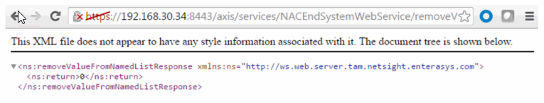

Example
Execute the following web service with a browser:
https://192.168.30.34:8443/axis/services/NACEndSystemWebService/removeValueFromNamedList?list=iOS&value=50:7A:55:6F:24:35&reauthenticate=true
