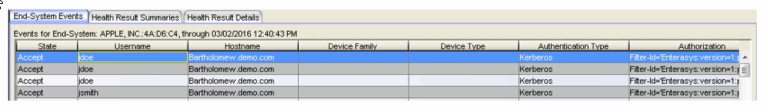

Example
Execute the following web service with a browser:
https://192.168.30.34:8443/axis/services/NACEndSystemWebService/sendKerberosMessageByMAC?macAddress=80:D6:05:4A:D6:C4&userName=jdoe&hostName=jdoe-test-system&lastSeenTime=0&lastAuthTime=0&sourceIp=192.168.30.34&clearUserName=false
