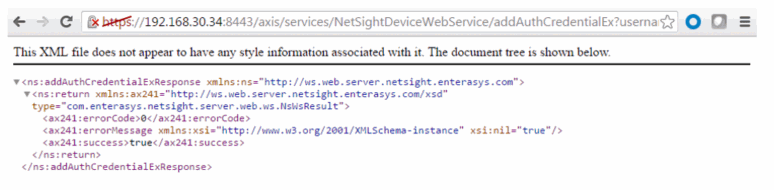

Returns
Returns a NsWsResult with a structure defined by the following table.
Name | Type | Description |
errorCode | int | See the Web Service Error Codes |
errorMessage | string | Error message in readable text |
success | boolean | True if operation is successful |

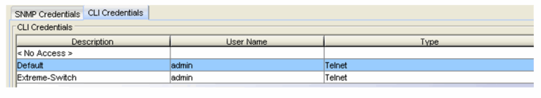

Example
Execute the following web service with a browser:
https://192.168.30.34:8443/axis/services/NetSightDeviceWebService/addAuthCredentialEx?username=admin&description=Extreme-Switch&loginPassword=password&enablePassword=&configurationPassword=&type=Telnet
