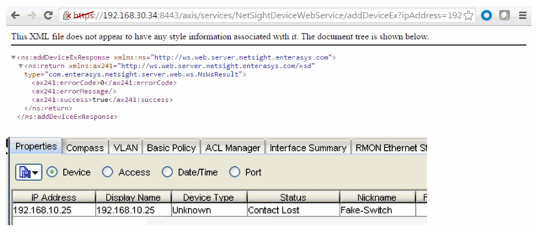

Example
Execute the following web service with a browser:
https://192.168.30.34:8443/axis/services/NetSightDeviceWebService/addDeviceEx?ipAddress=192.168.10.25&profileName=public_v1_Profile&snmpContext=&nickName=Fake-Switch
