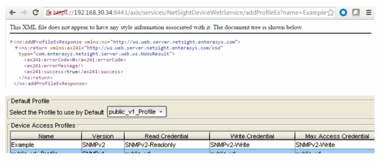

Example
Execute the following web service with a browser:
https://192.168.30.34:8443/axis/services/NetSightDeviceWebService/addProfileEx?name=Example&snmpVersion=2&read=SNMPv2-Readonly&write=SNMPv2-Write&maxAccess=SNMPv2-Write&auth=Extreme-Switch
