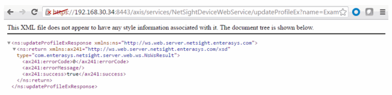

Example
Execute the following web service with a browser:
https://192.168.30.34:8443/axis/services/NetSightDeviceWebService/updateProfileEx?name=Example&read=public_v2&write=public_v2&maxAccess=SNMPv2-Write&authCredName=Extreme-Switch
