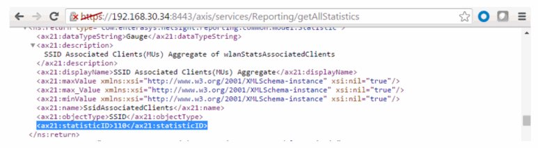

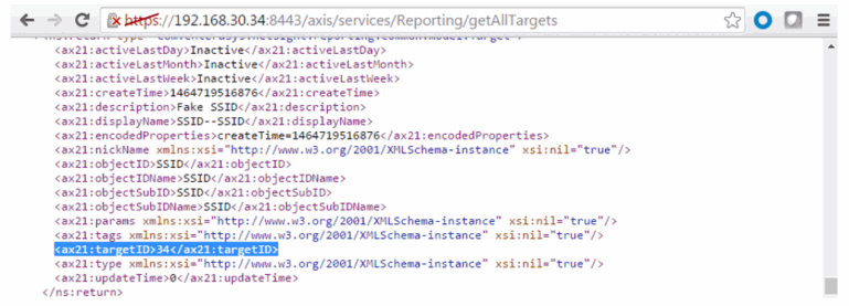

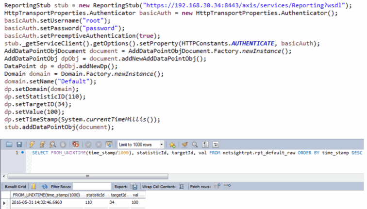

Example
This example sets the SsidAssociatedClients, with statisticID 100, on Fake SSID, with targetID 34, to 100.
