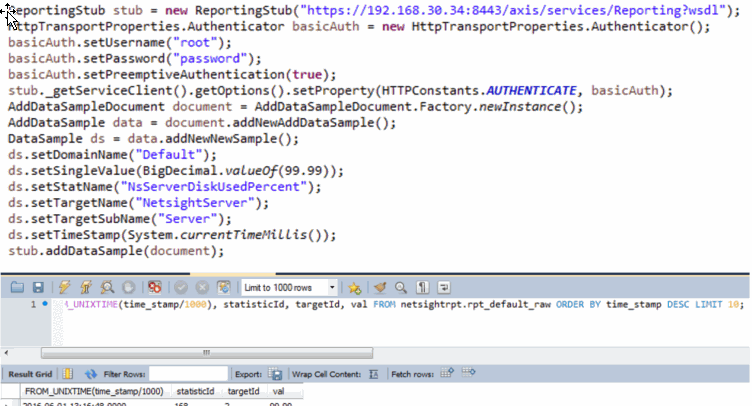

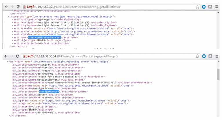

Example
This example sets the NsServerDiskUsedPercent statistic on the NetsightServer to 99.99.
