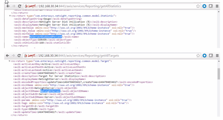

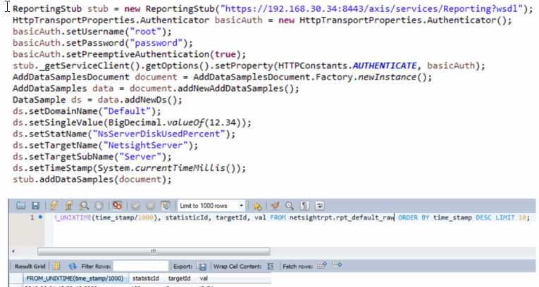

Example
This example sets the NsServerDiskUsedPercent statistic on the NetsightServer to 12.34.
