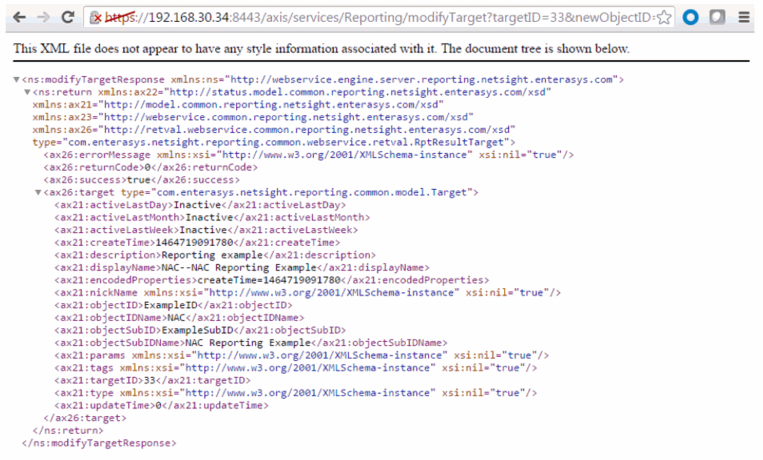

Example
Execute the following web service with a browser:
https://192.168.30.34:8443/axis/services/Reporting/modifyTarget?targetID=33&newObjectID=ExampleID&newObjectSubID=ExampleSubID
