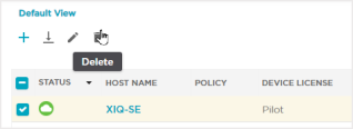

  1. Delete ExtremeCloud IQ Site Engine from ExtremeCloud IQ or Extreme Platform ONE Networking.

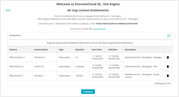

  4. Go to Air Gap License Entitlements using
    HTTPS://<SiteEngineIP>:8443/xiqLicenseSetup.jsp?setupMode=Airgap
  5. Copy the ExtremeCloud IQ Site Engine serial number (Locking ID, UUID) from the entitlements screen
  6. Generate a license file. Follow the license generation procedure in section Air gap deployment mode: Generate and Install the License File found in the Activation Instructions guide
  7. Drag and drop the license file in the Entitlements section of the Air Gap License Entitlements screen (see step 4).
  8. Click Continue
