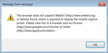

    To confirm compatibility with Webkit or Sencha Touch, open http://<ExtremeControlEngine IP>/mobile_screen_preview using your mobile web browser.
    • If the browser is compatible, the page displays properly.
    • If the browser is not compatible with the Mobile Captive Portal, the following error displays:
