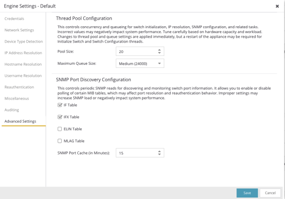

- Auditing
- Advanced Settings

Advanced Settings
Use this tab to configure advanced settings for your ExtremeControl engine, such as Thread Pool and SNMP Port Discovery.
Thread Pool Configuration
This option controls the concurrency and queuing of switch initialization, IP resolution, SNMP configuration, and related tasks. Incorrect values may negatively impact system performance. Tune carefully based on hardware capacity and workload. Changes to thread pool and queue settings apply immediately, but a restart of the appliance may be required to Initialize Switch and Switch Configuration threads.
- Pool Size
- You can increase the Pool Size value if the Access Control Engine takes an excessive amount of time to start or does not start because of too many switches. For 1000 switches, you can increase the Pool Size to 50. The default value is 20.
- Maximum Queue Size
- Do not change the Maximum Queue Size value unless instructed to by GTAC. The default value is Medium (24000).
SNMP Port Discovery Configuration
This option controls the periodic SNMP reads for discovering and monitoring switch port information. SNMP Port Discovery Configuration allows you to enable or disable the polling of certain MIB tables, which may affect port resolution and reauthentication behavior. Improper settings may increase SNMP load or negatively impact system performance.
- IF Table
- The standard classic interface table in MIB. The default is enabled (checked).
- IFX Table
- The newer enhanced interface table in MIB. Supports 64 bit counters, usually supported in platforms with 10G+ interfaces. The default is enabled (checked).
- ELIN Table
- The Emergency Location Identification Number table in MIB. The default is disabled (unchecked).
- MLAG Table
- The Multi-Chassis Link Aggregation table in MIB. The default is disabled (unchecked).
- SNMP Port Cache (in Minutes)
- The time until SNMP Port Cache is refreshed in minutes. The default is 15 minutes.
