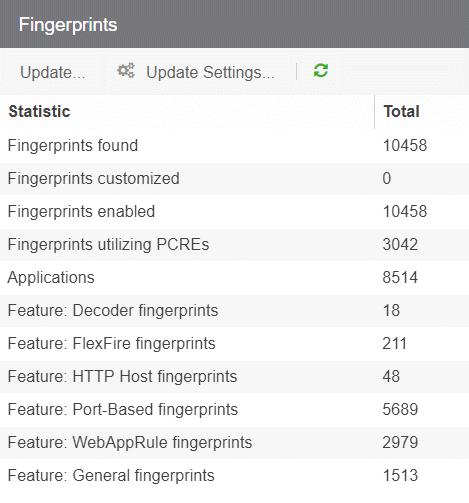

Fingerprints
View data for the application fingerprints in use.
Use the Menu icon (
) to access the following system fingerprint actions:
- Update
- Perform a manual one-time update of the fingerprint database.
- Update Settings
- Schedule fingerprint updates to be performed automatically on a daily or weekly basis.
Status
View a collection of ExtremeAnalytics system statistics, including Disk Usage and Approximate Row Counts, as well as Device Families and Profiles.

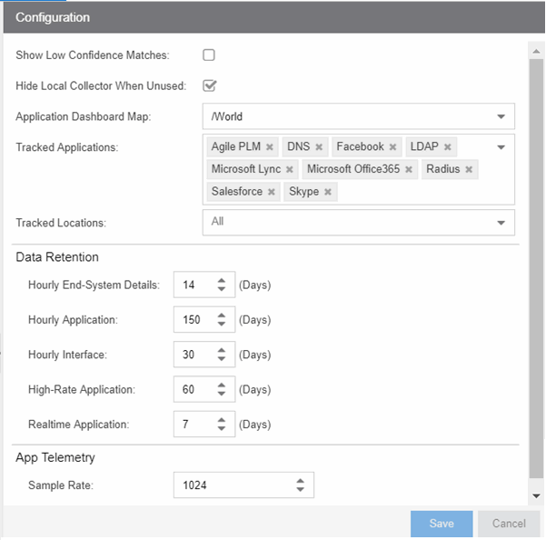

Configuration
Use the Configuration window to configure the application information displayed in the ExtremeAnalytics tab.
- Show Low Confidence Matches
- Check the box to display flows for which ExtremeCloud IQ Site Engine has low confidence.
- Hide Local Collector When Unused
- Check the box to hide local collector information when not in use.
- Application Dashboard Map
- Select from the drop-down list the map from which to draw application dashboard data.
- Tracked Applications
- Select the applications to track in the ExtremeAnalytics tab.
- Tracked Sites
- Select the sites to track on the ExtremeAnalytics tab. Tracked sites are also indicated on the Network > Devices > Sites > Endpoint Locations tab in the right panel.
- Data Retention
- Use this section of the tab to configure the amount of time ExtremeCloud IQ Site Engine saves flow data.
- App Telemetry
- This section enables you to configure the default sample rate ExtremeAnalytics uses when configuring ExtremeXOS/Switch Engine devices on which Application Telemetry is enabled.
