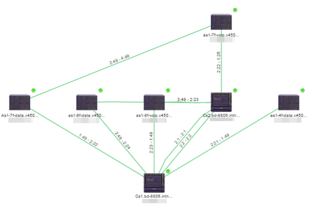

- Topology (default) - A topology map shows the state and speed of the network connections between devices as well as the state of the devices in the network.
Double-clicking a connection opens the Link Details window from which you can view additional details about the network connection and the devices it links.

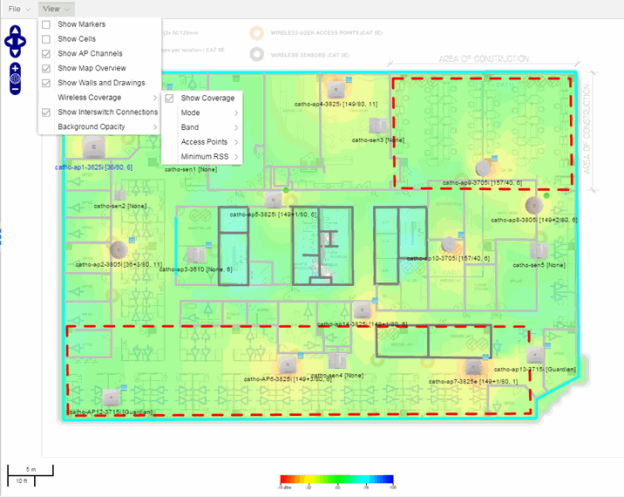

If you select Floorplan, select the map Environment, which is the type of environment where your network devices are physically located. - Open space — The wireless APs are located in an environment with no walls or cubicles.
- Office cubicles — The wireless APs are located in an environment with cubicle offices present.
- Drywall — The wireless APs are located in an environment where the office wall composition is drywall.
- Brick walls — The wireless APs are located in an environment where there are brick walls present.
- Custom — Use this option to create custom floorplans.

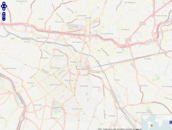

- Geographic — Displays a global or regional map where network locations are shown geographically.
If your map includes wireless APs, the environment is used for RSS-based (Received Signal Strength) location services to help determine the radius of the circle displayed around an AP following a wireless client search. The radius shows the possible area where the client is located. For example, if you select open space environment, then the radius of the circle is larger than if you select brick walls environment because the AP's radio frequencies are not be obstructed by any walls, and the area where a client might be located is larger.A Map Image field is displayed under the Environment field. In the Map Image field, use the drop-down list to select an image or select Add (
) to open a window where you can select a local image and upload it to the ExtremeCloud IQ Site Engine server.NOTE: If you upload a map image and an image with the same name already exists, the existing image is replaced. NOTE: The geographic map type is hosted by OpenStreetMap on an external server. For users with security concerns or if access to third-party servers is prohibited, use the topology map type.
